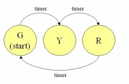

You can use the analogy of a traffic light which can be in one of three states: [GREEN], [YELLOW] or [RED]. It must only be in one state at a time. The traffic light is the actual state machine being modelled. It will normally transition its state from [GREEN to YELLOW], then [YELLOW to RED], then [RED to GREEN].
An alternative state transition (which is in effect in some countries like UK, has two transitions of [RED to YELLOW, then YELLOW to GREEN] in place of the [RED to GREEN] transition.
