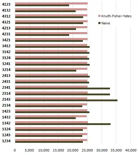

Let it run a bunch of times and visualize your data.
Here's an example of a shuffle from Coding Horror, you can see that the algorithm is OK or not:
It's easy to see that every possible item is returned at least once (the boundaries are OK) and that the distribution is OK.

  • Eh? The point of that visualisation is to show that the distribution is *not* okay. The naïve shuffle algorithm makes certain orders *much* more likely than others. Notice how far more to the right the 2341, 2314, 2143 and 1342 bars extend? – hvd Jan 02 '16 at 16:16
