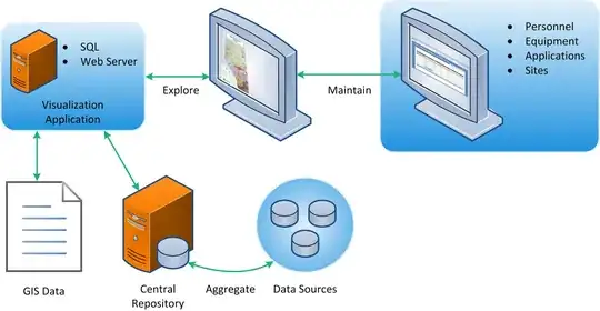

The following figure represents a high-level overview of the system's desired features:
The most basic usage would be as follows:
  1. The user visits a web site.
  2. The system presents a map (having regions, cities, and buildings).
  3. The user drills-down on the map to a particular building.
  4. The system provides a basic CRUD interface.
  5. The user can view and modify information about personnel (e.g., their assigned teams), equipment (e.g., network appliances), applications, and the building itself (e.g., contact and phone numbers).

Interesting, Im developing a similar system for oil & gas, with Google Maps API v3. We chose to use CouchDB for the part of your diagram that includes GIS data, central repository, and other data sources. The idea behind this is one container to hold disparate sources of data with different types of structure, and also actual data files that represent GIS layers, logs, tickets, etc.
Also the capability of being able to host actual applications directly from the DB server is helpful for processing/uploading data.
Ultimately for our system which was faced with the prospect of bringing together old + messy + unorganized data, This NoSQL + Schema-less setup has made working with different types of data a pleasure.

We went with the following:
  1. PostgreSQL + PostGIS
  2. Java 7 + Embedded Jetty + google-gson
  3. jQuery + OpenLayers + Select2
  4. OpenStreetMap + Mod Tile
We removed the reporting and data maintenance requirements.
