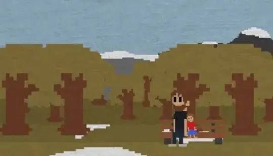

How about retro style? It's getting a resurgence. By that, I mean really chunky pixel art, like this:
It's old-school-stylish and this kind of style can actually pass for a commercial indy game.

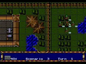

It's easier to use goofy perspective like in that screenshot above, or more appropriately for yours, a top-down view. If the concept of elevation is not absolutely crucial to convey visually, like in a tactical RPG or strategy game, you can always use tiles that kind of represent that concept another way. Example:
... you can use this kind of tile view with mountains and forests and stuff with varying elevation if it's a turn-based game. It doesn't communicate the concept of elevation so directly visually, but if it's not crucial to do so, this would really help you focus on the gameplay a lot more and this kind of style still tends to be popular on web and mobile kind of contexts.

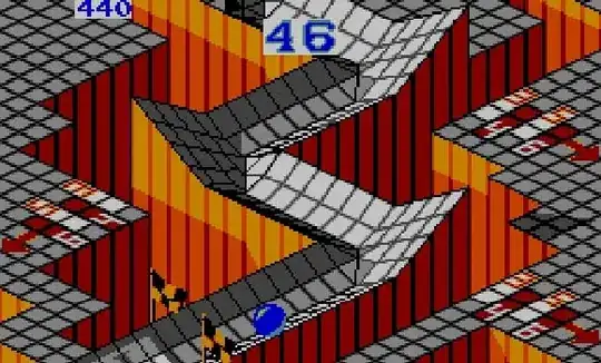

At least I used to draw sprites and tiles like in this immediate game above, and that was still time-consuming. Isometric would eat all my time, even though I still think 2D is easier. Maybe it would be useful to hook up with an artist buddy if the elevation concept is crucial to communicate visually, like in this game:
