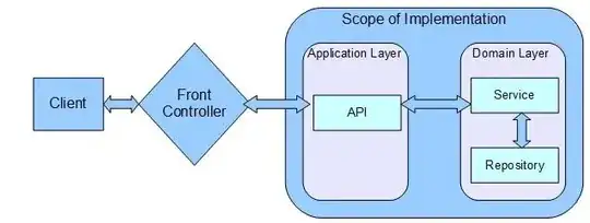

13
  • Application Layer and Domain Layer both comes under the scope of implementation.
  • Application Layer is acts as API.
  • Domain Layer is acts as a implementation of API, it contains business logic so it is also call Business Logic Layer.
Premraj
  • 836
    never though of it this way....I feel enlightened – Nikos Apr 22 '19 at 18:40
    I like this. @Premraj could you provide reference? – Christian H Jul 15 '21 at 23:05
  • it is not like that. What is difference between API in Application layer and Front Controller?? API is presentation layer at all. App layer consist of business use cases, wheras domain layer consists of business rules. – zolty13 Feb 11 '22 at 15:33
