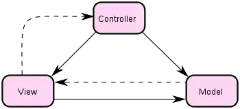

Model Concept....
The model manages the behavior and data of the application domain, responds to requests for information about its state (usually from the view), and responds to instructions to change state (usually from the controller). In event-driven systems, the model notifies observers (usually views) when the information changes so that they can react.
View Concept....
The view renders the model into a form suitable for interaction, typically a user interface element. Multiple views can exist for a single model for different purposes. A view port typically has a one to one correspondence with a display surface and knows how to render to it.
Controller Concept...
The controller receives user input and initiates a response by making calls on model objects. A controller accepts input from the user and instructs the model and a view port to perform actions based on that input.
MVC
also see the screenshot
Please read carefully and reply me if you have any Query regarding this @shayan

1read my question carefully i haven't ask the concepts of mvc framework.... – Shayan Husaini Mar 20 '12 at 10:38
your Question is belong to this Concept first you have to read carefully and reply me – Samad Mar 20 '12 at 10:45
In the original MVC pattern the Controller does not direct the View, it only observes the view. – kevin cline May 12 '14 at 19:31
