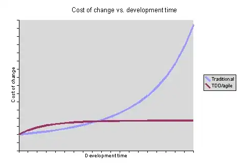

Errors found earlier is less costly to fix than errors found later. TDD helps you verify the correctness of your system. You invest a little more up-front, but get it back later. The graph is a bit exaggerated , but it shows the idea well.
Image Source
cst1992
  • 103
Martin Wickman
  • 13,305
  • 66
  • What do you mean by __traditional__? Anything that is not TDD? – Giorgio Jan 04 '18 at 08:55
  • It does not seem this graph is based on some real statistics, it only represents the experience of a single person who wrote this Blog entry in 2006. Not that I am saying it is utterly wrong, but the reality is far more complicated. – Doc Brown Jan 04 '18 at 08:59
