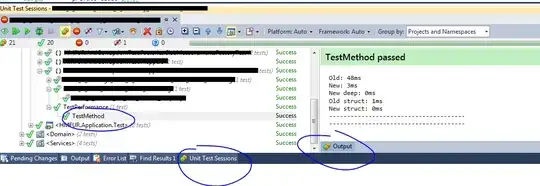

It turns out to see a test’s output, you just double-click on the test summary line, and all the output is down at the bottom of that window. You get Console.Out messages and (more importantly) {Trace,Debug}.WriteLine()
If you're using ReSharper, select your test method in the Unit Test Sessions pane, and the output will be in the Output tab:
In my case, I just needed to quickly test some performance. As I already have a unit test project, it was quicker to do it this way than having to create a new Console Application. So instead of just telling people why their question is wrong, I believe we should tell them why their question is wrong, but still try to answer the question.

    MAN this is difficult to find! Double-click, scroll down, click the tiny blue "output" link at the bottom. Thank you so much. – CindyH Mar 09 '16 at 16:20
