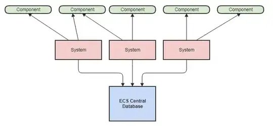

So the question is - how should I implement the interaction between the various systems?
Ideally they don't interact, not in any direct sense. The systems in an ECS all have access to the central ECS database where they can fetch entities and components attached to them. They don't talk to each other directly. They talk to the database and all run independently of each other.
Dependencies Flow Towards Raw Data, Not Abstractions
The dependencies in an ECS do not flow towards functions, not even abstract functionality. They all flow towards raw data which might sound like an epic violation of many accepted software engineering principles, and in my opinion it is, but yields something easier to maintain for some cases. Maybe some software engineering principles are wrong or at least not applicable for all scenarios. There are many situations where it's easier to achieve data stability than interface/design stability. As a basic example, it's much easier to reason about what data fields a raw matrix component should have once and for all and keep that stable (unchanging) for years to come. It's much harder to figure out all the functions an abstract IMatrix interface should provide once and for all and keep that perfectly stable (unchanging) for years to come without facing temptations, if not outright needs, to add and remove and change functions.
So in appropriate cases, when your dependencies flow towards data instead of abstract functionality, your codebase will find fewer and fewer and fewer reasons to have to face central design changes with cascading effects and potentially big parts having to be rewritten. To direct dependencies towards data in that case is directing them towards stability. It's worth asking yourself as a developer whether the tendency in your system is for developers to add, change, and remove functions or to add, change, and remove data from components. If it's the former case, you might benefit greatly from an ECS engine.
If systems start to depend on each other a lot, that's directing dependencies away from data and towards functionality, and many of the maintenance benefits and the ability to reason about the correctness of your engine and easily keep it stable at the design level will be lost. Of course a pragmatic solution might sometimes call for a system calling a function in another every once in a while, but you should generally seek to keep that to a bare minimum. Instead of talking directly to each other, you can have systems modify and attach components to entities in a way such that other systems can then pick up those changes and react accordingly.
System Interaction
[...] the rendering system must know the data from the positional component of an entity in order to draw it in a correct position. And so on.
That it can grab from the ECS database, looping through entities with renderable and position components, just as the physics system before it might loop through entities with position components and modify their position. Generally each system fits into a basic loop model:

Unlike GPU programming, you can still potentially do much more complex things in a single pass, but each pass will represent like one logical thought: "for each of these components, apply physics", not both physics and rendering. The physics system performs its own pass just as the rendering system, living in its own isolated world, performs its own completely separate and detachable rendering pass. Each system lives in its own little world, seeing only the ECS database and being able to grab components and entities inside. They shouldn't have to bother with what other systems are doing.
In fact, in a well-designed ECS, you can remove any system from the engine and not have the codebase collapse horribly on itself because systems don't depend on each other to function. All they care about is the central database and the components (which are raw data) that they are interested in processing. They all live in their own isolated world. As a result you should be able to remove the physics system from your game, at which point motion components will cease to have physics applied, but everything else should keep on working just as before. It's extremely orthogonal in that respect.
