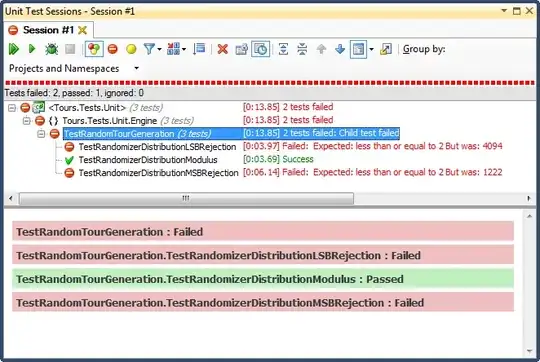

... and here's the results:
LSB rejection (bit-shifting the number until it falls within the range) was TERRIBLE, for a very easy-to-explain reason; when you divide any number by 2 until it's less than a maximum, you quit as soon as it is, and for any non-trivial range, that will bias the results towards the upper third (as was seen in the detailed results of the histogram). This was exactly the behavior I saw from the finished dates; all of the times were in the afternoon, on very specific days.
MSB rejection (removing the most significant bit off the number one at a time until it's within the range) is better, but again, because you're chopping off very large numbers with each bit, it's not evenly distributed; you're unlikely to get numbers in the upper and lower ends, so you get a bias toward the middle third. That might benefit someone looking to "normalize" random data into a bell-ish curve, but a sum of two or more smaller random numbers (similar to throwing dice) would give you a more natural curve. For my purposes, it fails.
The only one that passed this test was to constrain by modulo division, which also turned out to be the fastest of the three. Modulo will, by its definition, produce as even a distribution as possible given the available inputs.
