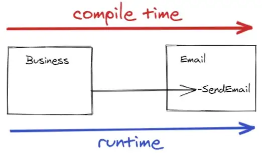

I think Inversion of Control(IoC) design principle has nothing to do with Dependency Injection(DI).
You can use DI in your project and still violate IoC principle.
Inversion of Control is all about "control flow" during runtime and during design time(source code).
Take two projects for instance, project Business and project Email where project Business calling some method(say SendEmail) in project Email.
During runtime flow of control goes from Business project to Email project, because Business project calling/depend/knows method from Email project.
During design or compile time flow of control goes in same direction, because in the source code we need to tell Business project what project we need to import to call SemdEmail method.
using Email; // dependency on Email project
namespace Business
    public class Order
        private readonly Email _email;
        public Order(Email email) // dependency on Email project
            _email = email;
        public static void CreateOrder(Guid customerId)
             _email.SendEmail(message);
Flow of control goes in same direction during compile and runtime
Why this is an issue?
Because now every time we make internal changes to the Email project we need to recompile all other projects which using it.

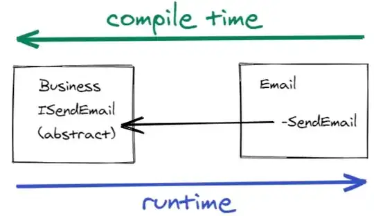

Inversion of Control principle suggests to change direction of control during compile time.
By making low level project (Email) depend on "higher" level project (Business). Then we can freely do internal changes into Email project without recompiling it's consumers.
To implement it we need to introduce an abstraction in Business project which Email project can implement.

Flow of control goes in opposite directions during compile and runtime
Every application has an entry point (main method), this is the place where we "glue" Business project with actual implementations.
