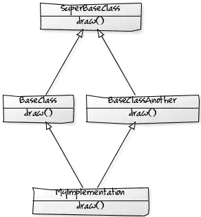

One of the problems associated with multiple inheritance is the hairy diamond inheritance problem. Consider if you have a language that allows this chain of classes in a language such as C++:
Diamond inherted class
Think of a SuperBaseClass that has two implemented BaseClass, both implementing the SuperBaseClass's method as virtual functions. In turn both BaseClass's are implemented by the MyImplementation class. Consider what will happens if you call super() in MyImplementation.draw()? It is not always apparent what will happen, even in C++, developers who have designed this will find themselves in a weird debugging session.
There is nothing particular wrong with diamond inheritance, so to avoid the problems of calling the super-method, you have to design them either by using pure virtual functions or design them in a smarter fashion. In Java, since all methods are virtual by default, you are constrained by the fact that you can only do multiple inheritance with interfaces since they don't contain any implementation (with the implements keyword). Other classes, even abstract ones, can only be single inherited (with the extends keyword).
