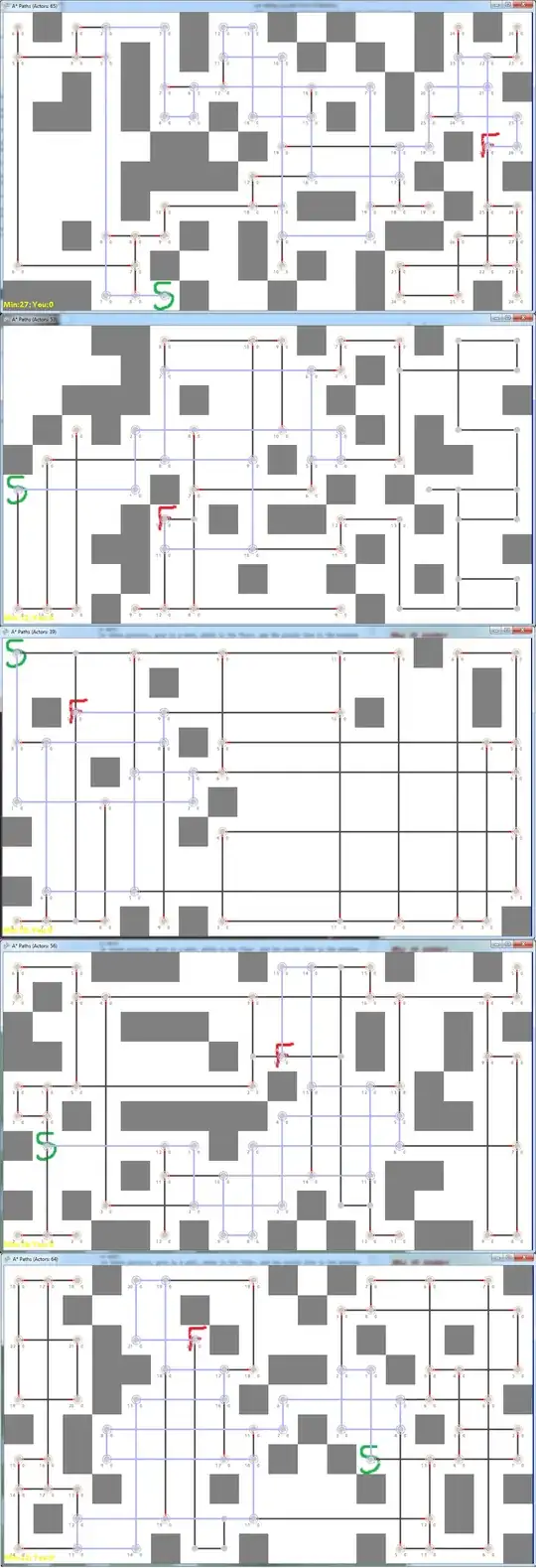

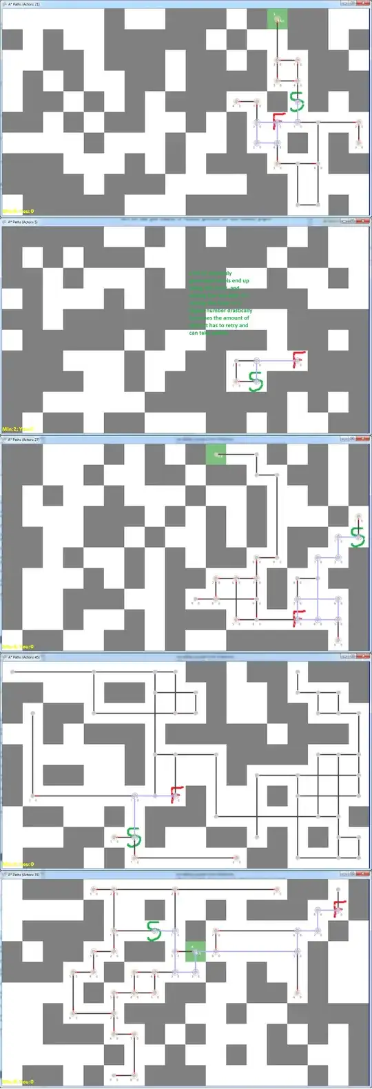

Here are some examples of what I have accomplished so far by just randomly placing blocks and generating the navigation graph from the chosen start/finish. The idea (as described in the previous link) is you start at the green S and want to get to the green F. You do this by moving up/down/left/right and you continue moving in the direction chosen until you hit a wall. In these pictures, grey is a wall, white is the floor, and the purple line is the minimum length from start to finish, and the black lines and grey dots represented possible paths.
Here are some bad examples of randomly generated graphs:
Here are some good examples of randomly generated (or hand tweaked) graphs:
I've also seemed to notice the more challenging ones when actually playing this as a puzzle are ones which have lots of high degree nodes along the minimum path.
