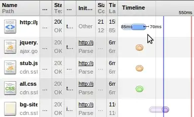

Now your application logs on your server have errors for long requests. You could even have it page you if something is slow! To tell the difference between browser time and server time, just use the built-in tools in Chrome or Firefox that show how long each part of a page building took. There's a timeline graph and other great stuff built-in there.
ChromeNetworkGraph
Maybe if you have an all-AJAX application it's an issue, but you can build this same timing into your server-side and send a timing result to the server.
