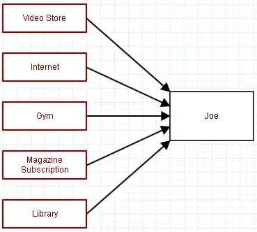

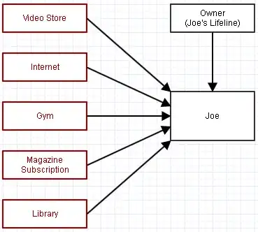

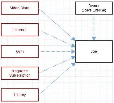

Let's take an example where we have this object, "Joe". Joe is referenced by a number of organizations to which he is a member. Every month or so they extract a membership fee from his credit card.
We also have one reference to Joe to control his lifetime. Let's say, as programmers, we no longer need Joe. He's starting to pester us and we no longer need these organizations he belongs to waste their time dealing with him. So we attempt to wipe him off the face of the earth by removing his lifeline reference.
... but wait, we're using garbage collection. Every strong reference to Joe will keep him around. So we also remove references to him from the organizations to which he belongs (unsubscribing him).

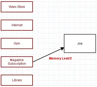

... except whoops, we forgot to cancel his magazine subscription! Now Joe remains around in memory, pestering us and using up resources, and the magazine company also ends up continuing to process Joe's membership every month.
This is the main mistake which can cause a lot of complex programs written using garbage collection schemes to leak and start using up more and more memory the longer they run, and possibly more and more processing (the recurring magazine subscription). They forgot to remove one or more of those references, making it impossible for the garbage collector to do its magic until the entire program is shut down.
The program doesn't crash, however. It's perfectly safe. It's just going to keep hogging up memory and Joe will still linger around. For many applications, this kind of leaky behavior where we just throw more and more memory/processing at the issue might be far preferable to a hard crash, especially given how much memory and processing power our machines have today.

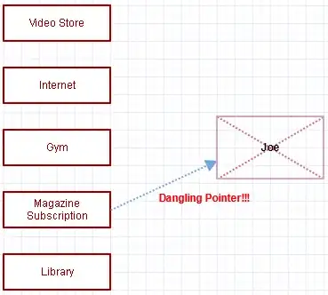

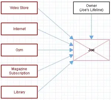

Now let's consider the alternative where we use pointers to Joe and manual memory management, like so:
These blue links don't manage Joe's lifetime. If we want to remove him from the face of the earth, we manually request to destroy him, like so:
Now that would normally leave us with dangling pointers all over the place, so let's remove the pointers to Joe.
... whoops, we made the exact same mistake again and forgot to unsubscribe Joe's magazine subscription!
Except now we have a dangling pointer. When the magazine subscription tries to process Joe's monthly fee, the entire world will explode -- typically we get the hard crash instantly.
This same basic resource mismanagement mistake where the developer forgot to manually remove all pointers/references to a resource can lead to a lot of crashes in native applications. They don't hog up memory the longer they run typically because they will often outright crash in this case.

Weak References
There is kind of a hybrid of these ideas available in GC schemes known as weak references. With weak references, we can have all these organizations weak-reference Joe but not prevent him from being removed when the strong reference (Joe's owner/lifeline) goes away. Nevertheless, we get the benefit of being able to detect when Joe is no longer around through these weak references, allowing us to get an easily-reproducible error of sorts.
Unfortunately weak references aren't used nearly as much as they probably should be used, so often a lot of complex GC applications might be susceptible to leaks even if they're potentially far less crashy than a complex C application, e.g.
In any case, whether or not GC makes your life easier or harder depends on how important it is for your software to avoid leaks, and whether or not it deals with complex resource management of this sort.
In my case, I work in a performance-critical field where resources do span hundreds of megabytes to gigabytes, and not releasing that memory when users request to unload because of a mistake like the above can actually be less preferable to a crash. Crashes are easy to spot and reproduce, making them often the programmer's favorite kind of bug, even if it's the user's least favorite, and a lot of these crashes will show up with a sane testing procedure before they even reach the user.
Anyway, those are the differences between GC and manual memory management. To answer your immediate question, I would say manual memory management is difficult, but it has very little to do with leaks, and both GC and manual forms of memory management are still very difficult when resource management is non-trivial. The GC arguably has more tricky behavior here where the program appears to be working just fine but is consuming more and more and more resources. The manual form is less tricky, but is going to crash and burn big time with mistakes like the one shown above.
