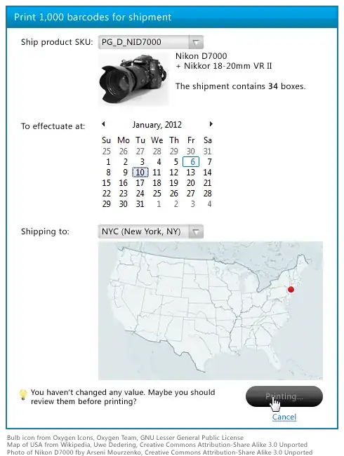

1. The magic undo
Yes, the users are in a time-critical environment. Yes, once the printer starts printing, it cannot be stopped. But there is still something you can do.
Even in a time-critical environment, chances are that printing right now and printing in five seconds will not change anything.
When the user clicks "Print", display a small "Undo" button, just like GMail does when you ask to remove, by mistake, all your mail. Wait for five seconds². Hide the "Undo" and only after that, print.
Now, the user has a chance to notice the mistake and cancel it before the harm is actually done, while the stuff is printed only with a small five seconds delay.
2. The discrete "default value" background
Is having default values suspicious?³ With one value, it's rarely suspicious. With three, there are chances that the cases when the user has to keep all three values by default are quite rare.
In this case, you can:
  • Highlight the value when it has its default value. Not in red: red is for invalid values. Set it to yellow-orange, and back to white when the user alters the default value.
  • Or disable the "Print" button until a value is changed. Add a checkbox nearby, which the user can check to confirm that his intent is to print with default values.
3. Enhance the UI of your controls
We are Friday, 6th of January 2012 today. What will be the date the next Thursday? Quick, quick, you're under pressure, you have only one second for your answer. Also, you're tired and there is a lot of noise all around. Not easy to answer, isn't it?
People can't manipulate dates easily when it's written as 1/8/1012. Saturday, 7th of January (tomorrow) is a bit easier. A graphical view which highlights Saturday and Sunday, shows today and the offset is even better.
Nothing is as ugly as "Location: NYC". Those three letters are meaningless when you're tired and work in a stressful environment; mistakes are easy. Instead, a graphical map of United States showing a red dot for New York city is much more appealing, and the user has much more chances to notice that, while he wanted to select San Francisco, the red dot seems to appear in a wrong place.
Would you enjoy if your GPS told you that you have to move from 38.90403, -77.04878 to 38.90568, -77.04665, then turn right and move to 38.90565, -77.04345, then turn 90° left and move to 38.90660, -77.04345? Would you be able to concentrate on your work (the road)? Showing 1/8/2012 and NYC to busy users is as friendly as a GPS that throws raw coordinates instead of a 3D view of a map full of color.
By providing richer controls and richer visualization of data, you can decrease the level of mistakes of your users in a stressful environment.
