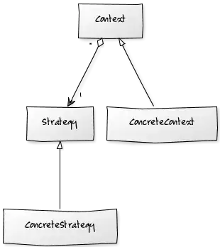

In a recent Java project I successfully added some generic abstract class because it satisfied some basic things: it made things easier for the others in the team, enforced the pattern that the architect already proposed and had some common code that programmers didn't need to copy and paste. It was a simple pattern that the architect wrote about that reasonably competent people still got wrong (because of the complexity of the actual system in play), but the generics marks which class goes where.
Obviously I can't show off the real example without breaching the non-disclosure agreement. But as an example of what I did would be to do the strategy pattern and enforcing it with generics. So this is the strategy pattern:
And in order for the programmers to enforce this pattern, you can add the generic type on Context that it should use something that has a Strategy type. Code-wise it would look something like this in Java:

  • Love the diagram! Which tool did you use? – yannis Dec 27 '11 at 10:46
  • @YannisRizos I used the http://yuml.me/ that creates diagrams from text input. The beta service is a bit buggy at the moment though (you can however upload the generated picture to your post using the generated link). – Spoike Dec 27 '11 at 10:49
  • bookmarked, thanks for sharing. although I don't really want to learn yet another syntax, however simplistic, it looks cool and I'll give it a go at some point. – yannis Dec 27 '11 at 10:52
  • @YannisRizos Oh, I constantly forget the syntax myself. That's why there is [a handy samples page](http://yuml.me/diagram/scruffy/class/samples). I found it to be quicker to write simple class diagrams in yuml than to use Visio. – Spoike Dec 27 '11 at 10:54
  • @YannisRizos yUml is a cool tool. Here are a few other examples of what you can do with it: http://carnotaurus.philipcarney.com/tagged/yUML – Phil C Dec 27 '11 at 10:55
