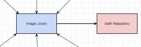

With incoming (afferent) dependencies but no outgoing (efferent) ones, and that made it build in a blink of an eye, made it very easy to deploy in any needed project (and I had been using it in many personal ones), and made it very stable. It had no reason to change as a result of something else changing, since it depended on nothing else.
But working with this team of OOP enthusiasts, and this was in the context of trying to move away from a legacy C codebase, we had the peer code reviews and they didn't like it. They thought it was too primitive and C-like. Someone also pointed out that it was duplicating some math functions in our math repository, like lerps and clamps and min/max functions operating on bytes. So one of the things they got me to do was to change the code to use our central math functions, and that wasn't related to OOP so much as DRY, but I hated it. So now I had to do this:
And in my opinion that made my image library so much uglier because our math "repository" (I refuse to call it "library") was not designed by people dedicating their time trying to figure out how to create a nice, minimalist math library with most of its responsibilities anticipated upfront. It was an eclectic mess of functions and classes programmers just added to whenever they needed something with no rhyme and reason to it and it was constantly changing so now my image library takes longer to build and has to be rebuilt all the time now depending on this unstable math repository.

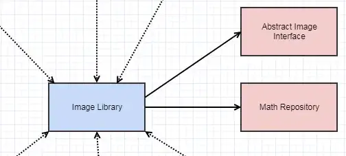

But it didn't stop there. We ended up introducing an abstract Image interface, so the next iteration was to make the functions operate on these image interfaces instead of raw pixels:
void image_filter(Image& image);
At which point the dependencies were like this:
And that image interface was also unstable and prone to change in ways I thought were really dumb, like people adding virtual methods to gaussian blur an image. Such methods need not belong in the interface when we could be defining and implementing them outside the class without making everything we could ever want to do with images a member function of an image interface*.

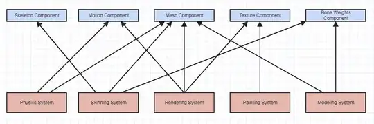

It is perhaps for a similar reason that I've come to like C so much again that I've also come to love entity-component systems. Their dependencies flow uniformly towards "raw data" rather than abstractions, and in my cases I've often found data to be easier to stabilize than abstractions on top of requiring fewer dependencies, less object->object interactions, etc.
It also suits my brain better? I mean, when I look at a large-scale codebase, it's not the complexity of any individual function that overwhelms me. It's the control flow and the number of interactions from one function to the next, abstract or not. You could show me a codebase with a thousand very simple objects and straightforward abstractions, all individually easy to understand, and I'd still be overwhelmed by what's going on between the objects and functions. The sheer number of interactions between everything and the complex graph of dependencies that results would overwhelm the mind.
And procedural code of the sort I'm describing that depends more on just "raw data" minimizes those interactions, keeps the call stack shallower, makes it so you can graph your codebase dependencies and not be overwhelmed by the result. It seems a lot of people focus on clean code at the intra-function or intra-object level, but the ultimate factor that leads to my ability to maintain and comprehend a system is generally more about the inter-function and inter-object level. I find it far more beneficial to minimize the interactions and complex control flows between code than to make any given function or object easier to comprehend, and favoring a more procedural mindset revolving around just loops that transform raw data tends to have that effect.
I also don't believe ECS to be object-oriented at all but far more procedural, since what in an ECS benefits conceptually from being an object? Systems don't benefit since they're generally decoupled and don't talk to each other. Components don't benefit since they model raw data. Entities don't since they just contain components. Even if we use OOP languages and model, say, systems as objects just for some minor conveniences, the entity-component systems as used in a lot of game engines ultimately model a very procedural mindset, so I would use such game engines that benefit from entity-component systems as an example of where procedural programming is more suitable and flexible than OOP.
