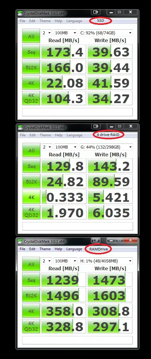

If you use a DVCS, then target SSD -> CPU frequency. Visual Studio is somewhat sensitive to CPU speed, and doesn't seem to be highly threaded. Prefer fewer faster cores over more slower cores. It doesn't seem to use much more than 1.5GB of RAM without running into OOM exceptions, so don't bother with shoving your machine full of more than 4GB of RAM. If you are lucky enough to have over 4GB of RAM, use the extra as a RAM drive to store your source code in (draconian backup measures necessary). Nothing can yet touch the speed of a RAM drive. Here's a benchmark from my workstation:
drive speed comparison between ssd/ramdrive/raid0
