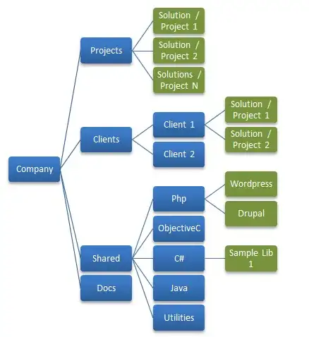

We have the following SVN structure.
  • Projects: Our work
  • Clients: Projects for clients, needs to be different
  • Shared: Shared libraries we created
  • Docs: Documents explaining how software development flows within the company (has nothing to do with my question anyway)
Where should we put the external libraries? Let's say from opensource projects etc.

Some people use Maven or similar solutions that automatically download libraries from various repositories as needed. It may be convenient, but then you're dependent on repositories maintained by some 3rd party. Getting some less popular libraries updated may be sluggish, and of course, most commercial libraries aren't available in public repositories.
We've simply put 3rd party libraries in our own repository under /lib/libraryname/tags/1.2.3/ and, using svn:externals, get those libraries to where they are needed. It may be a bit clumsy, some manual work is required to update the libraries, but at least your software is totally under your own control.
In technical sense, shared libraries are shared libraries regardless of who created them (you or someone else), so in your structure I would put them in /company/shared/3rdparty/etc.

    Fully agree. The external libraries definitely should be stored locally and `/company/shared/3rdparty/...` is good fit to the above structure. – Jan Hudec Nov 23 '11 at 11:06
