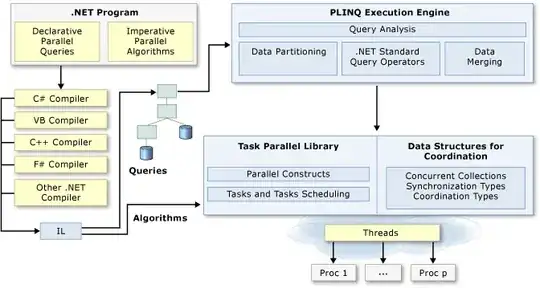

23
Take a look at Microsoft's Parallel Programming for .net. It is very intuitive.
Many personal computers and workstations have two or four cores (that is, CPUs) that enable multiple threads to be executed simultaneously. Computers in the near future are expected to have significantly more cores. To take advantage of the hardware of today and tomorrow, you can parallelize your code to distribute work across multiple processors. In the past, parallelization required low-level manipulation of threads and locks. Visual Studio 2010 and the .NET Framework 4 enhance support for parallel programming by providing a new runtime, new class library types, and new diagnostic tools. These features simplify parallel development so that you can write efficient, fine-grained, and scalable parallel code in a natural idiom without having to work directly with threads or the thread pool. The following illustration provides a high-level overview of the parallel programming architecture in the .NET Framework 4... http://i.msdn.microsoft.com/dynimg/IC292903.png

  • +1 This is a exactly what he is asking for. Though, when problems do occur, it will be difficult to debug them without an understanding of concurrency at a lower level. Not to mention, taking this on as a C# beginner could prove...interesting. – P.Brian.Mackey Nov 22 '11 at 18:40
  • @P.Brian.Mackey - I agree. However that is not uncommon, it wouldn't be a stretch to compare this to using ORMs when one does not fully understand relational model and SQL... – Otávio Décio Nov 22 '11 at 18:46
    Especially PLINQ. While it's useful only for a small subset of tasks, it can be *very* easy to use. – svick Nov 24 '11 at 17:33
