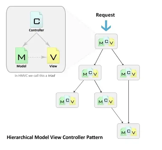

In the coming months we're going to begin a project where we take a system we've built for a client (v1) and rebuild it from scratch. Our goal with v2 is to make it modular, so that this specific client will have their own set of modules they use, then another client may use a different set of modules altogether. The trick here is that Company A might have a series of checkout and user modules that change how that system works. Company B might stick with the standard checkout procedure but customize how products are browsed.
What are some good approaches to application architecture when you're building an application from scratch that you want to have a Core that's shared among all clients while still maintaining the flexability for anything to be modified specifically for a client?
I've seen CodeIgniter's hooks and don't think that's a good solution as we could end up with 250 hooks and it's still not flexible enough. What are some other solutions? Ideally we won't need to draw a line in the sand.

To achieve highly organized and decoupled modularity, you can follow the Hierarchical MVC architectural pattern, sometimes known as Presentation–abstraction–control (although they aren't strictly the same pattern). Kohana, Alloy, Fluency and FuelPHP support HMVC natively* and Kohana's HMVC approach is discussed in Scaling Web Applications with HMVC and Optimising HMVC Web Applications for Performance, by Sam de Freyssinet.
Unfortunately CodeIgniter doesn't support HMVC natively. I've built my own libraries to provide some sort of HMVC support on CodeIgniter, taking some inspiration from wiredesignz's codeigniter-modular-extensions-hmvc. There's a very nice introduction to HMVC article at nettus+, that discusses CodeIgniter and wiredesignz's extension. The following image and quote are from that tutorial:
Each triad functions independently from one another. A triad can request access to another triad via their controllers. Both of these points allow the application to be distributed over multiple locations, if needed. In addition, the layering of MVC triads allows for a more in depth and robust application development. This leads to several advantages which brings us to our next point.
Finally, you are on the right track with hooks, even if you adopt an HMVC architecture, there is going to be some problems you'll still need to solve with hooks, depending on your implementation and the level of automation that you are looking for. A good use of hooks would be a pre_controller hook that would make sure all dependencies for installed modules are present, for example.
