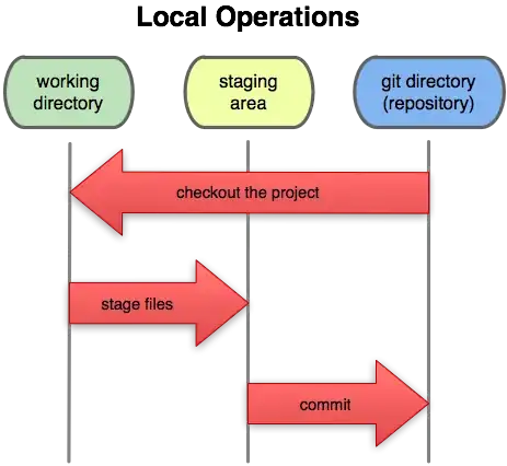

To stage a file is simply to prepare it finely for a commit. Git, with its index allows you to commit only certain parts of the changes you've done since the last commit. Say you're working on two features - one is finished, and one still needs some work done. You'd like to make a commit and go home (5 o'clock, finally!) but wouldn't like to commit the parts of the second feature, which is not done yet. You stage the parts you know belong to the first feature, and commit. Now your commit is your project with the first feature done, while the second is still in work-in-progress in your working directory.

    The second arrow "stage files" in the figure might be misleading. "stage hunks" might be more accurate? – Ida Oct 10 '14 at 13:44
  • @Ida - You have a point. Unfortunatelly, I don't have the time at the moment to make a better picture, but much appreciate pointing that out. Maybe one day I'll redo it... – Rook Oct 10 '14 at 14:53
