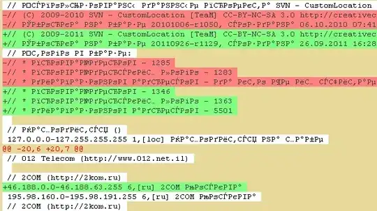

TortoiseMerge from TortoiseSVN can export result of files-compare to *.diff (if you don't want to use old good ported to Win diff -u)
TortoiseUDiff (from the same source) show this colored-diff (sorry for non-readable text - it's UTF8 without BOM, don't know how to visualize it in TortoiseUDiff correctly: never use this feature): red is deleted strings, green - added, white - context
