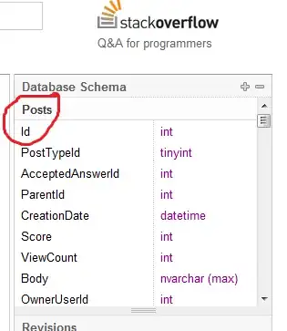

    Well if you do like table.ID you're in good company. see http://data.stackexchange.com – Conrad Frix Oct 17 '11 at 22:23

29
From data.stackexchange.com
Id in Posts
BOOM, question answered.
Now go tell your teacher that SO practice bad database design.
Cyril Gandon
  • 1,296
    My guess at the FKs, based on the names: `PostTypeId -> PostTypes.Id`; `AcceptedAnswerId -> Answers.Id`; `OwnerUserId -> Users.Id`. Why should a practice that is that easy be considered 'bad'? – Sjoerd Apr 18 '12 at 00:11
    How exactly does this prove anything about best practices? – GBa Apr 18 '12 at 15:52
    Whether something is used at stack or not does not prove if it's good or bad practice. – Pieter B Oct 20 '12 at 14:39
    What it does prove is that this practice in no way prohibits the scalability and usefulness of an application. – Cypher Feb 13 '15 at 20:49
    Actually SO practice is not perfect. I would use this naming: PostType -> PostType.Id; AcceptedAnswer -> Answer.Id; OwnerUser -> User.Id – alpav Feb 17 '15 at 02:10
