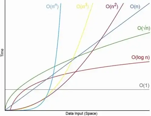

Note: Please read the comments by @back2dos below and other gurus, as they are in fact more helpful than what I have written - Thanks for all contributors.
I think from the chart below (taken from: Big O notation, search for "The Pessimistic Nature of Algorithms:"), you can see that O(log n) is not always better than say, O(n). So, I guess your argument is valid.
Pic-1

    The question wanted specific real world examples of algorithms. This does not have any as it stands. – Megan Walker Oct 07 '11 at 09:09
    You can see nothing on that graph, that would answer the question. It is misleading. This graph merely plots the functions `y = 1`, `y = log x`, and so on and the intersection of `y = 1` and `y = x` is actually the point `(1,1)`. If this really were correct, than it would tell you, that algorithms of higher complexity can be faster for 0 to 2 entries, which is something people hardly would care for. What the graph completely fails to take into account (and what the perceivable performance difference in question comes from) is constant factors. – back2dos Oct 07 '11 at 09:12
  • @Samuel Walker, thanks for the comment. The link provided (Link-1) has some examples of algorithms per category. – NoChance Oct 07 '11 at 09:14
    @back2dos: The graph on it's own does not answer the question, but can be used to answer it. The shape of each displayed function is the same for any scale and constant factor. With this the graph shows that given combination of functions, there is a range of inputs for which one is smaller and a range of inputs for which the other is. – Jan Hudec Oct 07 '11 at 11:42
  • @Caleb, it's not plotting `y=n^2, y=n^3...`, it's plotting examples of `y=O(n^2), y=O(n^3)...`. What is the complexity of an algorithm that does `n^3 + 2n^2` comparisons? Isn't it `O(n^3)`? – dan_waterworth Oct 07 '11 at 12:28
    @dan_waterworth, you're right, I'll concede that point and remove that comment. Nevertheless, the answer is incorrect or misleading in two respects: 1) The whole point of Big-O is that it gives an upper bound on complexity; it's only meaningful for large n because we explicitly toss out smaller terms which are overwhelmed by the largest term as n grows. 2) The point of the question is to find examples of two algorithms where the one with the higher Big-O bound outperforms one with a lower bound. This answer fails because it doesn't give any such examples. – Caleb Oct 07 '11 at 13:18
  • @Caleb, now we are in agreement. – dan_waterworth Oct 07 '11 at 14:19
  • ln(n) < n for all n > 0. That graph is misleading and worse than useless. – Phob Aug 23 '12 at 19:20
  • The problems with this: 1: Labels are asymptotic but graph is real time. This isn't clearly explained. If you have two graphs, that fixes. Use a plotter and put in the formulas in the O. 2: Data input is float not natural numbers. Can be tolerable though. 3: Scale not clear (actually it kind of is with O(n) being 45 degs). – jgmjgm Jan 09 '19 at 22:17
  • @jgmjgm, there is a room for improvement. – NoChance Jan 10 '19 at 08:34
