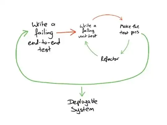

What I think BDD makes a bit more explicit than TDD, or at least formalises and provides tool support for, is this two-cycle / double loop / zoom-in zoom-out / outside-in approach. You first describe the expected behaviour of the feature (the outside loop), then zoom-in to the inner loop to deal with the low-level specifications.
Doubleloop TDD From http://www.metesreau.com/ncraft-workshop/
Gherkin in conjunction with tools like Cucumber and SpecFlow provide a way of writing those high-level feature specifications and then linking them in to code that executes the application code. I would argue that this is where BDD might 'feel' different from TDD, but it really still is doing the same thing, just with some added tool support and a DSL. Somewhat closer to 'traditional' TDD is using tools like rspec, nspec, spock. These feel a little more like the same process you'd do in 'traditional' TDD but with more behaviour-focused language.
In BDD in Action by John Ferguson Smart (highly recommended), he advocates for a double loop approach, starting with something like jBehave at the outer level executable specifications, then dropping into a tool like Spock for the low-level specifications.
