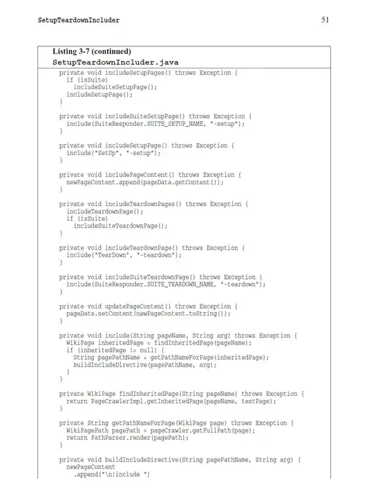

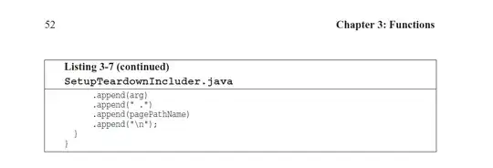

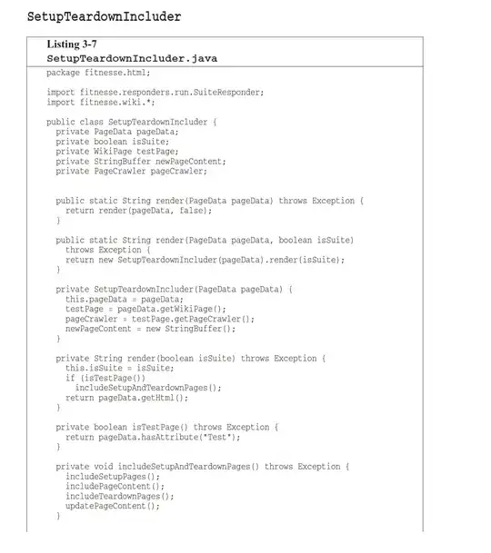

I'm reading Robert C. Martin's "Clean Code" and I had this same question. Code listing 3-7 is an example of where the choice was made to keep state in private fields, rather than passing down state to helper functions.
I have to agree with what the other posters have said; that it makes the code more maintainable and understandable to avoid keeping state in private members that don't quite fit with the abstraction.
Looking at this example:
first part of a code listing second part of a code listing third part of a code listing
It didn't make sense to me that this class SetupTeardownIncluder should have state as well as a static method for render. I would argue that the class should be renamed to PageDataWithSetupTeardown, it should have a constructor that takes a PageData and a boolean, and the static render should be removed and replaced by, a non-static public render() that would call the private render(boolean) method.
So instead of calling something like
SetupTeardownIncluder.render(pageData, isSuite);
You could do something like:
(new PageDataWithSetupTeardown(pageData, isSuite)).render();
matthiasdenu
