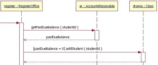

As in many types of UML diagrams, you can use guards to denote a condition. A guard is a boolean expression that you can write over a transition.
Here's a picture with an example: enter image description here
Notice the "[pastDueBalance = 0]" condition.
You can also use combined fragments for more complicated conditional logic. See this nice msdn article for further information.
