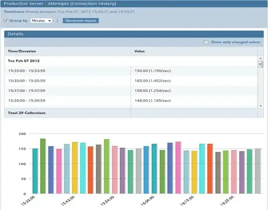

I will also like to bring a monitoring tool that can be also to used as data versioning tool. The tool I am talking about is MONyog, actually it is an MySQL monitoring tool but with a little hack we can easily use it as data versioning.
But before going further i will quote that it will not be advisable to put up whole of the database for versioning. It is be real killer to track change for a particular set of data.
MONyog has a feature called CSO (Custom SQL Objects), which can monitor the change in particular set of data. Adding a CSO is described here. Now in MONyog's monitor history section you can get a the changes over a period of time. Best, it gives a visual report in html page. The report will look something like this enter image description here
