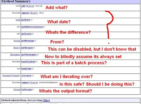

It seems a bit of a controversial subject to document everything, including the "JavaBean" syntax of getters and setters for fields: People say its needlessly long and repetitive breaking DRY (don't repeat yourself), that the naming convention should explain everything, and it clutters code/documentation. Sometimes those arguments work. But other times, you end up with this:
alt text
Above is common to open source projects that do boldly follow those principles. You're left with entirely useless documentation. That doesn't explain anything about what's going on underneath, the possible effects, or even what the expected value is (could it be null or never null? I don't know; the Javadoc doesn't tell me).
So when should I document? Do I document everything even if it occasionally clutters code? Or do I document nothing since in my eyes it's "obvious"?

    to a certain degree this shows a naming problem e.g. getDate should be getCreationDate or getExpiryDate or what ever make sense in the domain. Of course naming isn't a panacea. – jk. Sep 20 '12 at 09:16

Document everything that makes sense to document.
In an ideal world, yes, you would document everything. However, on Earth, we have deadlines, feature cuts, families and friends to visit, vacations to take, only 24 hours in a day and only 365 days in a year. There's just not enough time to document everything. So, optimally, document everything you can (you won't get done), but get the most bang for your buck by:
  • Make code readable and method signatures as obvious as possible so that documenting is less likely to be needed.
  • Documenting the most obscure things first. Help out others by documenting the crazy hacks you had to do to get things out the door.
  • Document the why before the what - Don't comment what something does, like "Iterate over the customer records where balance is less than zero and rating is less than one and add them to the exemptCustomers list". Document why you are adding them to the list in plain english (or your team's language), like "Since these customers have a negative balance and low ratings, they are causing us to lose money, so exclude them from being able to check out.
