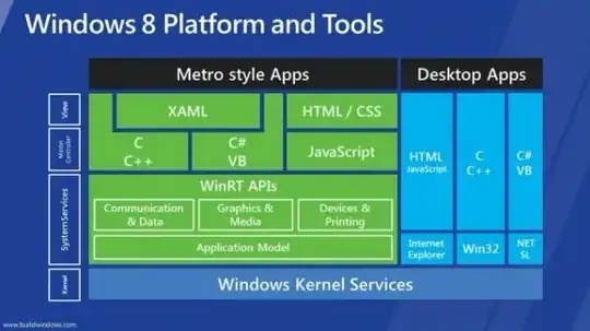

As I understand it WinRT is a new framework sitting on top of the Windows Kernel. Most functionality of .Net should be available in WinRT as well although namespaces and implementations may differ.
What happens to WPF or Silverlight is anyones best guess, they didn't get much mention on Build yet. I suppose Silverlight will see a final version 5 and .Net 4.5 but I doubt both will be advanced that much further. On the other side WinRT apps only run on Win8 and some apps don't even make sense in Metro-Design so MS should/could/who knows? be working on improvements to the .Net Framework for some time/forever. ;)

    see also http://dougseven.com/2011/09/15/a-bad-picture-is-worth-a-thousand-long-discussions/ in which Doug Seven offers "more correct (but still marketecture that is not wholly technically accurate)" "boxology." – StevenV Sep 16 '11 at 18:27
I've found a blog entry from Julian Bucknall that summarizes the keynote along with two slides. Maybe this will shed some light for your question, but always remember: it's a beta thing and might change regardless what is published now and by whom ...
