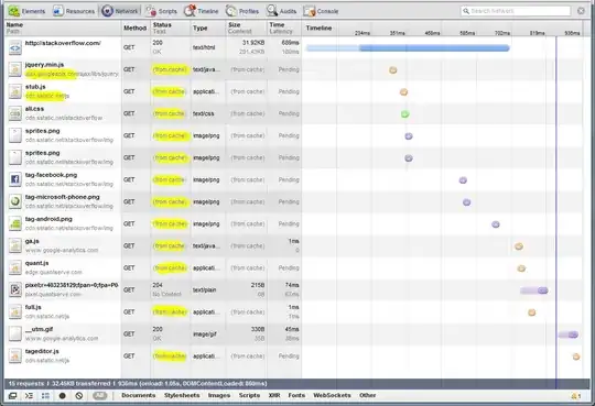

Here's for example a screenshot of what's happening when I come to Stack Overflow home page:
A screenshot of Stack Overflow timeline in Chrome shows 15 files, 3 being requested, 12 being served from cache directly with no requests to remote servers
There are 15 files to serve. But where are all those 304 Not Modified responses? You only have three requests of content that changed. For everything else, the browser uses the cached version without making any request to any server.
To conclude, you really need to think twice before implementing your own cache mechanism, and especially find a good scenario where this can be useful. As I said at the beginning of my answer, I can find only one: where you are serving chunks of JavaScript to use them through, OMG, eval(). But in this case, I'm pretty sure that there are better approaches which are either:
