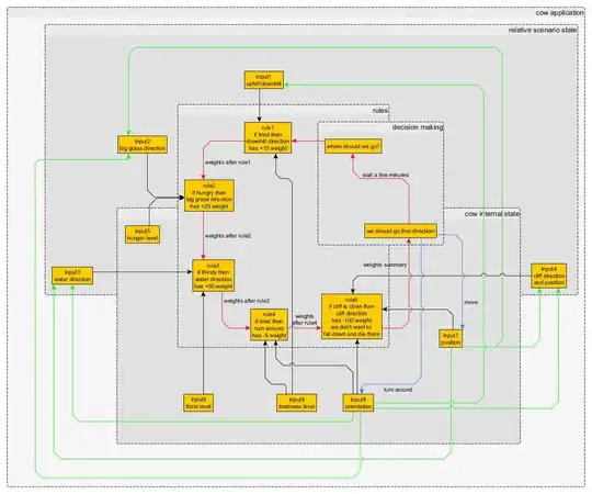

I am considering building an application, which, at its core, would consist of thousands of if...then...else statements. The purpose of the application is to be able to predict how cows move around in any landscape. They are affected by things like the sun, wind, food source, sudden events etc.
How can such an application be managed? I imagine that after a few hundred IF-statements, it would be as good as unpredictable how the program would react and debugging what lead to a certain reaction would mean that one would have to traverse the whole IF-statement tree every time.
I have read a bit about rules engines, but I do not see how they would get around this complexity.

You are trying to model how cows are moving through a terrain. Though your question lacks details I would guess that your large amount of ifs include decision fragment such as if cow.isStanding then cow.canRun = true but you get bogged down as you add details of terrain for example. So for every action you want to take you have to check every aspects you can think of and repeat these verifications for the next possible action.
First we need our repeatable design, which in this case will be a FSM to model the changing states of the simulation. So the first thing I would do is implement a reference FSM, defining a state interface, a transition interface, and perhaps a transition context that can contains shared information to be made available to the other two. A basic FSM implementation will switch from one transition to another regardless of the context, this is where a rule engine comes in. The rule engine cleanly encapsulates the conditions that must be met if the transition is to take place. A rule engine here can be as simple as a list of rules each having an evaluate function returning a boolean. To check if a transition should take we place, iterate the list of rules and if any of them evaluate to false, the transition does not take place. The transition itself will contain the behavioural code to modify the current state of the FSM (and other possible tasks).
Now, if I start to implement the simulation as a single large FSM at the GOD level I end up with a LOT of possible states, transitions etc. The if-else mess looks like it's fixed but it's actually just spread around: each IF is now a rule that performs a test against a specific information of the context (which at this point pretty much contain everything) and each IF body is somewhere in the transition code.
Enter the fractals breakdown: the first step would be to create a FSM for each cow where the states are the cow's own internal states (standing, running, walking, grazing etc) and transitions between them would be affected by the environment. It's possible that the graph is not complete, for example grazing is only accessible from the standing state, any other transition is dissalowed because simply absent from the model. Here you effectively separate the data in two different models, the cow and the terrain. Each with it's own properties set. This breakdown will allow you to simplify your overall engine design. Now instead of having a single rule engine that decides all you have multiple, simpler rule engines (one for each transitions) that decide on very specific details. Many games company are using finite state machines such as this to decide on such aspects.
Because I am re-using the same code for the FSM this is basically a configuration of the FSM. Remember when we mentioned DSL's earlier? This is where the DSL can do a lot of good if you have a lot of rules & transitions to write.

I don't think you should define so many if-else statements. From my point of view your problem has multiple components:
  • It should be async or multithreaded, because you have multiple cows with different personalities, different configuration. Each cow asks herself which direction to go in before its next move. In my opinion a sync code is a poor tool for this problem.
  • The configuration of the decision tree constantly changes. It depends on the position of the actual cow, the weather, the time, the terrain, etc... Instead of building a complex if-else tree, I think we should reduce the problem to a wind rose or a direction - weight function: figure 1 figure 1 - direction - weight functions for some of the rules
    The cow should always go to the direction which has the greatest sum weight. So instead of building a big decision tree you can add a set of rules (with different direction - weight functions) to each cow, and simply process the result by each time you ask the direction. You can reconfigure those rules by every position change, or by passing of the time, or you can add these details as parameters, every rule should get. It is an implementation decision. The simplest way to get a direction, to add a simple loop from 0° to 360° with 1° step. After that you can count the sum weight of each 360 direction and run through a max() function to get the proper direction.
  • You don't necessarily need a neural network to do this, just one class for each rule, one class for the cows, maybe for the terrain, etc... and one class for the scenario (for example 3 cows with different rules & 1 specific terrain). figure2 figure 2 - cow app async decision nodes and connections
    • red for messaging direction - weight map through the rules
    • blue for orientation and position updates after decision making
    • green for input updates after orientation and position update
    • black for getting inputs
    note: you'll probably need a messaging framework to implement something like this
    So if making learning cows is not part of your problem, you don't need a neural network or genetic algorithms. I am not an expert of AI, but I guess if you want to adapt your cows to the real ones, then you can do it simply with a genetic algorithm and the proper set of rules. If I understand well, you need a population of cows with random rule settings. After that you can compare the behavior of real cows to the behavior of your model population and keep 10% which walk the closest path to the real ones. After that you can add new rule configuration constraints to your cow factory based on the 10% you kept, and add new random cows to the population, and so on, until you got a model cow which behaves just like the real ones...

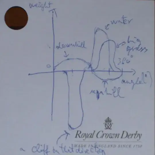

Since your looking at movement of the cow, they are stuck in 360 degree direction( cows can't fly.) You also have a rate that your traveling. This can be defined as a vector.
Now how do you deal with things like the sun position, slope of the hill, loud noise?
Each of the degrees would be a variable signifying the desire to go in that direction. Say a twig snaps to the right of the cow at 90 degrees (assuming the cow faces 0 degrees). The desire to go to the right will go down and the desire to go 270 (left) will go up. Go through all the stimuli adding or subtracting their influence on the cows desire to go in a direction. Once all the stimuli is applied, the cow will go in the direction of highest desire.
You can also apply gradients so the stimuli doesn't have to be binary. For example a hill is not straight up in one direction. Maybe the cow is in a valley or on a road on a hill were its flat straight ahead, at 45* slight up hill at 90* slight down hill. At 180* steep up hill.
You can then adjust the weight of an event, and it's direction of influence. Rather then a list of if thens, you have one test looking for the max. Also when you want to add a stimuli you can just apply it before the test and you don't have to deal with adding more and more complexity.
Rather then saying the cow will go in any 360 direction lets just break it down into 36 directions. Each being 10 degrees
Rather then saying the cow will go in any 360 direction lets just break it down into 36 directions. Each being 10 degrees. Depending on how specific you need to be.
