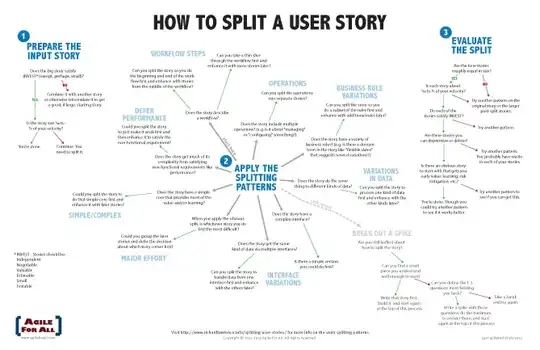

I agree with 4 weeks being a long sprint these days. You want to decrease the feedback loop and getting better at turning small units of work around in shorter iterations. That way there is less to go wrong, less that will change and less complexity to manage in one go.
Splitting stories is often a trouble area for people but you get better with it the more you do. Work closely with the PO to work out if you can deliver it in stages and still deliver value in the sprint.
Here is a great poster that helps with splitting stories, its from a website called agileforall.com and you can find the poster here, its really useful to have this up as you refine backlog items:
http://agileforall.com/wp-content/uploads/2012/01/Story-Splitting-Flowchart.pdf
It is also good to have your definition of done available when you refine and plan so that you can keep that in mind when committing to complete something in one short sprint.

  • That poster is almost completely unreadable at the current resolution. – Bryan Oakley Aug 04 '16 at 14:40
    Apologies, try the edited link ;-) – Anthony Joanes Aug 05 '16 at 13:20
  • [patterns-for-splitting-user-stories](http://agileforall.com/patterns-for-splitting-user-stories/) describes the linked flowchart and the corresponding [Story-Splitting-Cheat-Sheet](http://agileforall.com/wp-content/uploads/2009/10/Story-Splitting-Cheat-Sheet.pdf) has fewer informations but is much easier to read. – k3b Aug 02 '17 at 09:10
