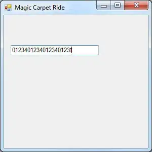

Add this to the list:
The presented scenario is simple (even more simple as I will present it here than it was originally!): 1.A WinForms TextBox sits on a Form, empty. It has a MaxLength set to 20.
2.The user types into the TextBox, or maybe pastes text into it.
3.No matter what you type or paste into the TextBox, you are limited to 20, though it will sympathetically beep at text beyond the 20 (YMMV here; I changed my sound scheme to give me that effect!).
4.The small packet of text is then sent somewhere else, to start an exciting adventure.
Now this is an easy scenario, and anyone can write this up, in their spare time. I just wrote it up myself in multiple programming languages using WinForms, because I was bored and had never tried it before. And with text in multiple actual languages because I am wired that way and have more keyboard layouts than possibly anyone in the entire freaking universe.
I even named the form Magic Carpet Ride, to help ameliorate the boredom.
This did not work, for what it's worth.
So instead, I entered the following 20 characters into my Magic Carpet Ride form:
0123401234012340123
Uh oh.
That last character is U+20000, the first Extension B ideograph of Unicode (aka U+d840 U+dc00, to its close friends who he is not ashamed to be disrobed, as it were, in front of)....
And now we have a ball game.
Because when TextBox.MaxLength talks about
Gets or sets the maximum number of characters that can be manually entered into the text box.
what it really means is
Gets or sets the maximum number of UTF-16 LE code units that can be manually entered into the text box and will mercilessly truncate the living crap out of any string that tries to play cutesy games with the linguistic character notion that only someone as obsessed as that Kaplan fellow will find offensive (geez he needs to get out more!).
I'll try and see about getting the document updated....
Regular readers who remember my UCS-2 to UTF-16 series will note my unhappiness with the simplistic notion of TextBox.MaxLength and how it should handle at a minimum this case where its draconian behavior creates an illegal sequence, one that other parts of the .Net Framework may throw a
  • System.Text.EncoderFallbackException: Unable to translate Unicode character \uD850 at index 0 to specified code page.*
exception if you pass this string elsewhere in the .Net Framework (as my colleague Dan Thompson was doing).
Now okay, perhaps the full UCS-2 to UTF-16 series is out of the reach of many.
But isn't it reasonable to expect that TextBox.Text will not produce a System.String that won't cause another piece of the .Net Framework to throw? I mean, it isn't like there is a chance in the form of some event on the control that tells you of the upcoming truncation where you can easily add the smarter validation -- validation that the control itself does not mind doing. I would go so far as to say that this punk control is breaking a safety contract that could even lead to security problems if you can class causing unexpected exceptions to terminate an application as a crude sort of denial of service. Why should any WinForms process or method or algorithm or technique produce invalid results?
Source : Michael S. Kaplan MSDN Blog
