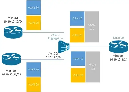

The topology diagram below shows multiple CPE devices, each has multiple WAN sub-interface that are dot1q tagged as VLAN 10 and 20 in this example. The PE ME3600 devices has an SVI with an IP address in a /24 range in VLAN 20 and each CPE has a WAN interface encapsualted in VLAN 20 within the same /24. This topology is all configured an working just fine. A CPE can ping .1 and the PE can ping .10 for example.
The layer 2 aggregation device adds a QinQ outer tag to each CPE connection so that at the PE device each layer 2 connection can be differenciated between despite trunking the same VLANs to each CPE with their IPs being in a /24.

What I want to know is;
How can I see the outer tag the ME3600 will apply to frames sent out towards one of the CPEs, lets say 10.10.10.10? Something like show ip cef exact-route or show ip arp that shows the path the traffic will take through the EFPs and EVC back towards the CPE?
The test scenario is that I want to see what outer tag will be applied by the PE device when sending taffic to 10.10.10.15, the 2nd CPE (which allows me to verify that 10.10.10.15 came in on VLAN 102 and was correctly encapsulated from the downstream layer 2 aggregation device which is not Cisco and out of the scope of this question - I'm looking solely at the ME3600)
