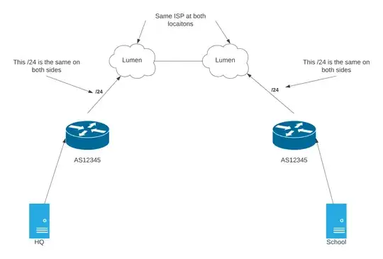

The setting: Two locations I'm trying to connect. I have a /24 address block from ARIN Both location have the Same ISP.
The Question:
  • Can I announce the same /24 address block at the HQ location to Lumen?
  • Can I announce the same /24 address block at the School location to Lumen?
Since /24 is the smallest I can announce. At the end of the day, I'm also trying to connect these two locations. Thanks in advance for any advise.

You can announce it from both locations, but the result will be that traffic to the IP block will be delivered to whichever location provides the "best" route for the traffic, which may or may not be the site you want the traffic delivered to.
Assuming you want to split the IP block between the two locations then I see two basic approaches.
  1. Speak to your ISP. See if they are prepared to announce the /24 block on your behalf and route sub-blocks of it to your two sites.
  2. Establish a private link (this may be a VPN, but if it is a VPN then the VPN endpoints must not use IP addresses from the split block) between the two sites. Traffic arriving at the "wrong" site would be sent over the private link to the "right" site.

Yes, you can announce the same prefix in multiple location on the Internet. It is called anycast, and you see examples all the time, e.g. Google's 8.8.8.8 DNS server. Google has the network with that host address in many places around the world, and when you try to connect to that host, BGP routes your traffic to the nearest (from a BGP perspective) location.
The real problem you have is trying to connect between the two locations. You cannot connect from the /24 network at one site to the same /24 network at a different site. You could do something like having half the addresses at each location, but you will need to have something like a separate link (real or a tunnel) between the two sites, and one site receiving traffic for the other site needs to forward the traffic over the link to the other site.
You really have not provided enough information in order to give a more specific answer.

  • For some more context. I'm trying to use my allocated IP block address since I'm at 0% IP utilization. I understand I could do an IPsec for the two locations, but if I wanted to use my own IP block, if possible. Hope this gives more information. I don't know what other info i could give please advise thanks – 13months May 05 '22 at 03:37
  • ... or you could use another set of IP addresses to route between sites. – Zac67 May 05 '22 at 05:53
    Accurate, I could, but I'm worried that if I do that, I'll be wasting a 254 IPs when at the school site; I'll only use like 2 or 3 ips – 13months May 05 '22 at 07:05

In general, NO, you cannot.
As others mention, you could announce same /24 from different locations that some things like anycasting, but that requires stateless protocols like UDP (so no using "fancy" TCP stuff like WWW, e-mail etc.). But it would not work for the purpose you seem to want.
Depending on your ISP goodwill (and your exact needs) however, you might be able to:
  • use IPv6 (which you can easily get in abundance) instead of scarce IPv4 (provided your use case is happy with that, of course).
  • subnet that /24 into two /25, and use different /25 on each location (and have each location only announce its /25). Sure, wider internet will would not accept smaller than /24 announcements, but BGP as a protocol allows it, and as both your connection travel via same ISP, the ISP could happily aggregate them back to /24 for announcing to the wider world. But it requires goodwill (and some technical competence) at the ISP.
