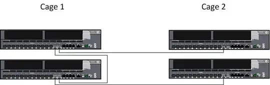

IRF - linear topo
This is a pretty standard topology, in that I link the new switches back to the other pair in a linear topology. Anything in Cage 2 needing to go to the other switch will have to transit the full stack, though. I know this will work.
The question here is, can I short-circuit that with a ring topology? Does IRF allow that?

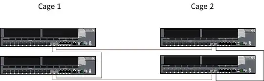

IRF - ring topo
This would allow a shorter transit of packets. That said, I don't know if IRF allows this kind of setup. If it doesn't...

IRF definitely supports a ring topology, and as long as that setup makes sense for your environment, then it's definitely the preferable way to expand.

IRF is nice technology. I have experience with them. Yes, you can expand the stack pretty well. Go with a ring topology by adding new switches like you show in the second picture. However you have to keep in mind several considerations: stack is nice, but it can fell apart with, so in this case two IRFs with MAD (Multi Active Detection) will work better, but provide more overhead (you'll have to provision two stacks instead of one, may be you'll need to reconsider your failover scenario etc)
