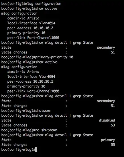

Also, is there a way (even if it's not necessary) to force one of the members to become primary? I found the command primary-priority here, but the command does not exist on my switch.
The primary-priority command is a hidden command that will still take effect even though it looks like it doesn't exist on your switch.
You just have to type out the whole command and press Enter. You can confirm that the command has taken effect by performing a show active (as you can see in the picture)
Example Configuration
