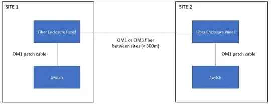

We need to have fiber connection between two sites (distance less than 300 meters from each other). Currently there is multi-mode fiber connected to old switches working nicely. Now we are updating our switches to 10Gb and trying to connect, but it doesn't work (no signal lights).

OM1 or OM3 makes a lot of difference. Please check https://en.wikipedia.org/wiki/Multi-mode_optical_fiber . You will see that OM1 cable can carry 10G for 33 meters while OM3 can carry it for 300 meters. OM3 application first started in 1998 but standardized in 2002. Most probably, your fiber is OM1 like your patch cords. Best practice would be
1- Check for markings on physical cable for information
2- Call a cabling company with a fiber tester. They will tell you everything about the infrastructure.

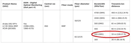

From the J9150D datasheet you linked, the max transmission distance over an OM1 fiber is 33m.
Thus you need other transceivers, or to change the fiber.

  • The transceiver is fine - OP said they weren't sure if the fibre between sites was OM1 or OM3. It's likely OM1/2 and, if so, it's the fibre that will likely need to change. – J... Apr 27 '20 at 20:18
  • It if was OM2 it would not change much the issue, the max transmission distance over OM2 for those transceiver being 82m. But yes, changing the fiber is probably the way to go. – JFL Apr 27 '20 at 21:17
