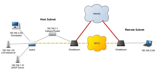

So, the host subnet is 192.168.0.0/23 and the remote subnet is 192.168.2.0/23. Each of the Windstream routers have two ports - one for MPLS and one for internet. Right now, the internet port at the remote is not connected. The internet port on the host router runs through our firewall router before entering the host network, but the MPLS port at the host plugs directly into the switch-trunk.
The two Windstream Routers each have an MPLS port:
  • 192.168.1.2 = Host MPLS
  • 192.168.2.2 = Remote MPLS
The Windstream routers also each have an open internet port to which I have attached a Firewall Router for filtering the internet, making the internet gateways:
  • 192.168.1.1 = Host Gateway
  • 192.168.2.1 = Remote Gateway

Here is a map: enter image description here

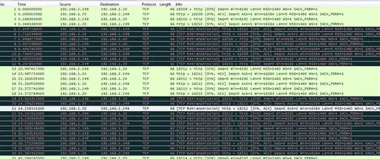

[update] When I run Wireshark on the webserver and watch the request for the webpage, I see alot of retransmissions on the http calls. Here is the report: enter image description here
It looks like http traffic from the remote to the host is what is getting retransmissions. But I've got no equipment that can block it. The firewalls are all off.

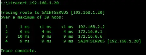

Trace-Route from the webserver to the remote computer: enter image description here

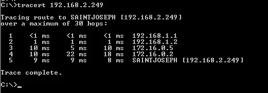

Trace-Route from the remote computer to the webserver: enter image description here

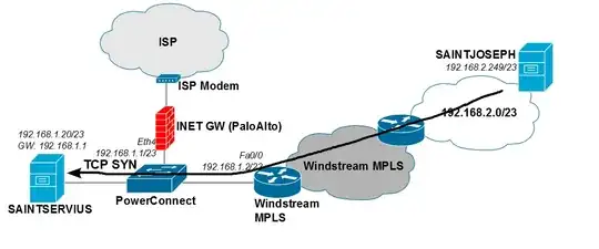

Following up on our chat discussion, the exact problem is that SAINTJOSEPH's TCP SYN packets are delivered correctly; however, stateful inspection on your PaloAlto firewall drops SAINTSERVIUS' TCP SYN-ACK response, due to asymmetric routing in your environment. This is illustrated in the two following diagrams.
TCP SYN from SAINTJOSEPH to SAINTSERVIUS:
sspx_Before02
Your PaloAlto firewall drops the TCP SYN-ACK from SAINTSERVIUS to SAINTJOSEPH:

This tracert makes it very clear that SAINTSERVIUS defaults through 192.168.1.1 (the PaloAlto firewall):

You should only have a single router next-hop for every subnet; however, you currently have two. This results in the drops shown in your wireshark screen capture (which indicates that TCP SYN-ACK packets never reach Windstream's MPLS network).

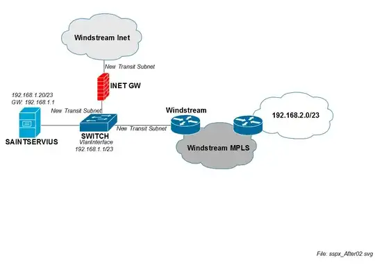

Better Design, Option B (MPLS re-addressing required)
This is a another way to lay out the subnet for SAINTSERVIUS (retaining your numbering scheme with /23 subnets, although it's not required...). This option offloads interoffice LAN routing to your PowerConnect switches, and relies on the PaloAlto firewalls to protect against internet threats.
sspx_After02
This is a long-term solution. You would have to work with Windstream to readdress your infrastructure. This is a lot of work, but it offers the advantage of not having to deal with firewalls for your interoffice communication.
