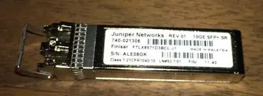

We have 2 Juniper EX 3300 switches operating in a stack. It is running Junos 12.3R3.4. The switches have 4 SFP/SFP+ Ports. On FPC 1, PIC 1, Xcvr 0 you see a description of "SFP-FC8G-SW." However, the transceiver is a Juniper branded 10GE SFP+ SR (see image below).
The interface is up/down. On the client side the physical media indicates that it is connected but there seems to be no link layer connectivity. No traffic passes on the interface.

  • Maybe I am missing it, but there doesn't seem to be a question in the post. However, have you tried this in another port or device to see if you get different results? Can you loop it back to itself? – YLearn Feb 27 '14 at 21:09
  • @YLearn, sorry, the question is: What might cause this behavior? What next troubleshooting steps might I take towards finding a resolution? Juniper wants to RMA the switch. I will try what you suggest. – sardean Feb 27 '14 at 21:19
    pull the SFP, check the serial numbers match. – Ricky Feb 27 '14 at 21:23
    @DeanA.Vassallo, I think Ricky and I are thinking along the same lines. While the switch could be at fault, it is far more likely that the actual transceiver doesn't match the label on the outer metal casing. – YLearn Feb 28 '14 at 01:28
  • @DeanA.Vassallo So, you're saying JTAC wants to RMA the switch before the Transceiver? That's very uncommon, SFPs are (normally) the first things to go. – Ryan Foley Feb 28 '14 at 08:33
  • @RickyBeam You were correct, the serial numbers did not match, the transceiver was an 8G FC transceiver. I realized this when I put it into a "known good" port. The "show chassis hardware" updated confirming that the transceiver was mislabeled. I placed a 10G SFP+ SR module in on my trouble port and the issue is resolved. – sardean Feb 28 '14 at 17:13
  • @DeanA.Vassallo, please answer your own question below and mark it accepted so it doesn't show up in the list of unanswered questions. – Mike Pennington Mar 07 '14 at 12:27
Quick test: Swap the SFPs with a known working ones on the switch (if possible) and see if the condition stays with the ports or follow the SFPs.
If the other SFP works in the current "problematic SFP ports" there is less possibility of this being the switch's problem (I still could be, but just unlikely).
You can try to plug it in the other switch's too... if it's problematic there, it's almost guaranteed to be the SFP, unless you got the One-In-A-Million chance of having two switches with exactly the same freaking bug - extremely unlikely
If after all that JTAC still insist for RMA on both switches, just escalate the issue to get someone more reasonable at their end.
Edit: I've just seen that it was a mislabeling issue, you might want to mark this question as answered. :)
