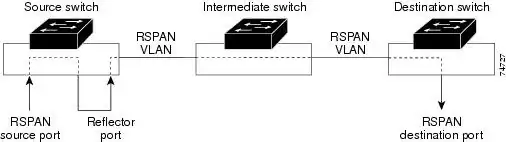

Even though SPAN can (will) drop frames when TAP would not, Cisco switches (and maybe others) have a cool feature called RSPAN.
It allows to set up a remote SPAN, to transport captured frames over the network to the monitoring station:
cisco_rspan

  • There are some limitations to RSPAN, specifically it is a layer 2 only solution. If you need to send the traffic off to another subnet, you'll have to look at ERSPAN: http://www.cisco.com/en/US/docs/routers/7600/ios/12.2SXF/configuration/guide/span.html#wp1059482 – Brett Lykins May 20 '13 at 04:24
