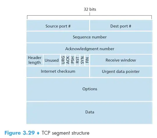

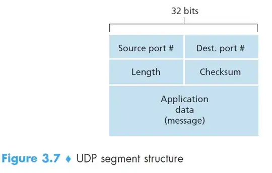

So I'm reading Computer Networking: A top down approach (where these images are from) and I was looking at the Transport layer.
A generic segment in the transport layer has a pretty simple structure: source port, destination port, some other header fields, and application data.
Then comes UDP and TCP, which are also from the transport layer, but have some differences in how they're handled and all of that.
Looking at the images bellow, there's really no field where the segment can be identified as TCP or UDP, right?
So when the PC tries to demultiplex the segment into the respective socket, how does it know whether it is UDP or TCP?
enter image description here enter image description here enter image description here

    The type of layer-4 protocol is always stored in the IP header (layer-3 header). When an IP packet arrives, the IP software is responsible for calling the UDP software, TCP software or GRE software etc. Therefore the information if the packet is a UDP or a TCP packet is needed by the IP software, not by the TCP or UDP software. For this reason it makes sense to store it in the IP header. – Martin Rosenau Jan 21 '19 at 06:17
IP knows. For IPv4 there is a 8bit protocol field where 6 represents TCP and 17 UDP. In IPv6 there is an equivalent next-header.
You can see all reserved protocol types here: https://www.iana.org/assignments/protocol-numbers/protocol-numbers.xhtml
