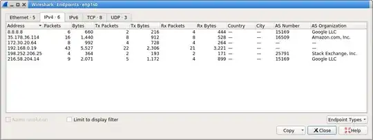

    It's certainly possible to do this with Wireshark's > Statistics > Endpoints command but needs a little setting up. I've edited the question to ask about standard tools, and voted to reopen. I'll happily add the answer if this reopens. – jonathanjo Jan 16 '19 at 17:39
You can certainly do this with Wireshark.
In the menu choose Statistics > Endpoints and you will see a window like this: enter image description here
You might need to copy and paste into Excel to sum the bytes per AS, or use some awk/python one-liner.
If the columns marked AS Number and AS Organization are blank throughout, you need to configure the database for looking these up. It can be a little tricky to find the information but it's well described at Wireshark's documentation https://wiki.wireshark.org/HowToUseGeoIP and summarised here:

  • Say where the MaxMind databases are going to go (Edit > Preferences > Name Resolution)
  • Download Max Mind's (free) Autonomous System database, unzip it, and put in the directory of previous step
  • Reload Wireshark
You will also be able to see the Autonomous System information on the per-packet analysis, and use it in filters and so on.
