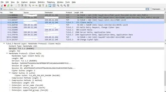

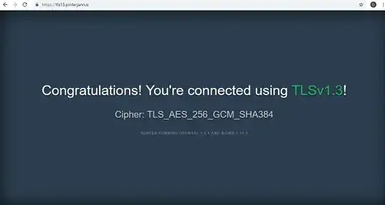

I'm accessing TLS 1.3 test server "https://tls13.pinterjann.is" via a java http client using TLS 1.3. Everything seems to work fine as the html response indicates:
HTML Response
What I don't understand: Why does Wireshark show in the overview Protocol TLSv1.3 but in the details Version TLS 1.2?

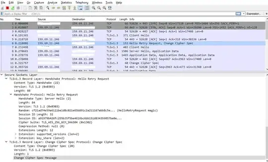

Wireshark ClientHello Wireshark HelloRetry Wireshark ClientHello 2 Wireshark ServerHello

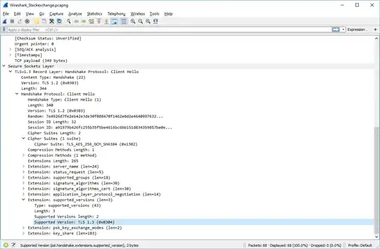

Sorry, for the confusion, I was missing the exact TLS 1.3 semantics: For instance, in the Client Hello, the field "version" must contain the fixed value 0x0303 (TLS 1.2), while the prefered version is contained in the extension "supported versions".
From RFC 8446 (TLS 1.3 spec):
struct {
      ProtocolVersion legacy_version = 0x0303;    /* TLS v1.2 */
      Random random;
      opaque legacy_session_id<0..32>;
      CipherSuite cipher_suites<2..2^16-2>;
      opaque legacy_compression_methods<1..2^8-1>;
      Extension extensions<8..2^16-1>;
  } ClientHello;
legacy_version: In previous versions of TLS, this field was used for version negotiation and represented the highest version number supported by the client. Experience has shown that many servers do not properly implement version negotiation, leading to "version intolerance" in which the server rejects an otherwise acceptable ClientHello with a version number higher than it supports. In TLS 1.3, the client indicates its version preferences in the "supported_versions" extension (Section 4.2.1) and the legacy_version field MUST be set to 0x0303, which is the version number for TLS 1.2. TLS 1.3 ClientHellos are identified as having a legacy_version of 0x0303 and a supported_versions extension present with 0x0304 as the highest version indicated therein. (See Appendix D for details about backward compatibility.)
This agrees with what Wireshark displays:
Wireshark supported versions

Recall that TLS sessions begin with a handshake to negotiate parameters such as the protocol version and ciphers. The client sends a Client Hello handshake message in a TLS record containing:
  • TLS Record - Version: minimum supported TLS version (in TLS 1.2 and before). In TLS 1.3, this field is not really used and MUST be 0x0303 ("TLS 1.2") or 0x301 ("TLS 1.0") for compatibility purposes. Reference: RFC 8446 (page 79)
  • Client Hello - Version: maximum supported TLS version (in TLS 1.2 and before). In TLS 1.3, this field is not used but MUST be set to 0x0303 ("TLS 1.2"). Reference: RFC 8446 (4.1.2. Client Hello)
  • Client Hello - Supported Versions Extension: list of supported versions. This is the only value used by TLS 1.3 implementations (which may agree TLS 1.3, 1.2 or other versions). Reference: RFC 8446 (4.2.1. Supported Versions)
The server sends a Server Hello handshake message with:
  • Server Hello - Version: negotiated version (for TLS 1.2 and before). If TLS 1.3 is negotiated, it MUST be set to 0x0303 ("TLS 1.2").
  • Server Hello - Supported Versions: a single negotiated version (for TLS 1.3). Cannot be used to negotiate earlier versions.
So in TLS 1.2, the client sends a range of supported versions while a TLS 1.3 client sends a list of supported versions. The server will then pick a single version, but for compatibility purposes it will use a new field for selecting TLS 1.3 or newer.
(Even if a client advertises support for some version (e.g. via a TLS record version containing "TLS 1.0"), it could still fail the handshake though if the server agrees to this low version.)
Another thing to be aware of: Wireshark tries to interpret a packet immediately as it is received. At the time the Client Hello is received, it will not know the final version and therefore assume the TLS Record Version. When the Server Hello is received, it can adjust the version accordingly:
