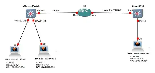

Edit: Added a diagram:
NAT Diagram
The idea would be that SIM1-S1 would NAT to 10.0.10.2, SIM1-S2 would NAT to 10.0.10.3, etc... SIM2-S1 would NAT to 10.0.20.2, SIM2-S2 would NAT to 10.0.20.3, etc...

  • I edited the above post and included an image hopefully that helps make more sense of it! R1 in the diagram would be the NAT device. Subinterface f0/0.10 would be the gateway for VLAN10 with 192.168.1.254 and subinterface f0/0.20 would be the gateway for VLAN20 with 192.168.1.254, etc... This is why I was thinking about VRF. – umhelp Oct 20 '18 at 20:15
  • Assuming you'll have subinterfaces `fast0/0.10` and `fast0/0.20` and `fast0/0.nn` (with their respective 802.1q tag) on that router, I doubt that it will allow you to configure overlapping IP ranges on the subinterfaces. When I tried, my C891-24X just barked: `% 192.168.1.254 overlaps with GigabitEthernet0/1.10`. I don't see this happening without VRFs. What router model do you have there, and how many interfaces does it have? – Marc 'netztier' Luethi Oct 20 '18 at 20:29
  • We haven't decided on any hardware yet, but I have an ASR-1001-X to play around with and the only image I have for GNS3 is a c7200 to mess around. Either way neither of them would allow overlapping IPs. – umhelp Oct 20 '18 at 20:35
With a bit of VRF-lite and VRF-aware-NAT and the help of the Cat-3850's routing capability, here's some config snippets that should work, or at least get you halfway there - all based on the diagram you showed.

  • For some reason I was hung up on moving all the routing into the router and lost sight of the bigger picture. I was able to use this config and get a working example in GNS3. – umhelp Oct 21 '18 at 02:23
    Your pseudo code was pretty close. I change interface fast0/1.10 to ip nat outside. The ip nat inside statements needed match-in-vrf on the end and for some reason the routes as listed didn't work but ip route vrf SIM1 0.0.0.0 0.0.0.0 10.0.10.254 did work. I had to use an L3 Extreme Networks Virtual Switch in GNS3 since I can't load up a 3850 but the principles are effectively the same. – umhelp Oct 21 '18 at 02:36
