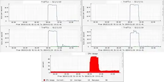

The impact of the flood was kind of weird, the only thing that seem affected was normal IPv4 DHCP requests, regular clients couldn't get a IP address, but those who already had one before the flooding started experienced no problems... The CPU's on the switches also peaked to 95-100%, but did not seem to impact normal traffic switching/routing operations.
What we need help to determine is how only 30mbps of IPv6 multicast traffic can push the CPU on a 6509 SUP720 to 100% and make normal IPv4 DHCP to stop working and how to protect ourselves against this should it happen again.

And a little collection of graphs to illustrate the impact:
CPU Spike Graph

What does this mean to you? Well your current storm-control configuration throttles traffic at 5% of line-rate, so you're allowing 74.4kpps of traffic to hit your switch before storm-control kicks in. 74.4kpps * 64-byte frames is 38Mbps, which is right at what your graphs show:

So, the bottom line is that you're allowing too much traffic to hit the switch CPU, which is why the CPU utilization was high. 74.4kpps is really too much to allow any switch CPU to process.
