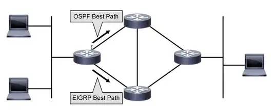

I have given the following network diagram and been told that,
Since EIGRP has a better (lower) administrative distance than OSPF, the router on the far left will use the EIGRP path and publish only the EIGRP path to the destination network in its routing table.
Cisco Systems, Inc
Question: Why does EIGRP have a better (lower) administrative distance than OSPF?
Image courtesy: Cisco Systems, Inc

That is because Cisco determines the AD used by its devices, and EIGRP is a Cisco protocol, so Cisco decided to make EIGRP have a lower AD than other protocols.
Each vendor determines the relative reliability of protocols for its equipment; there is no outside standard for this. Some vendors may not even have an AD equivalent.

The AD is a vendor concept (from the vendor who in this case is Cisco), independent of the routing protocols. It is just Cisco's way of prioritizing between routes from different routing protocols, in cases where multiple routing protocols are running at the same time.
Since, furthermore, EIGRP was created by Cisco (unlike OSPF), it is not surprising that Cisco may slightly prefer EIGRP over OSPF and therefore assign it a better/smaller AD.
